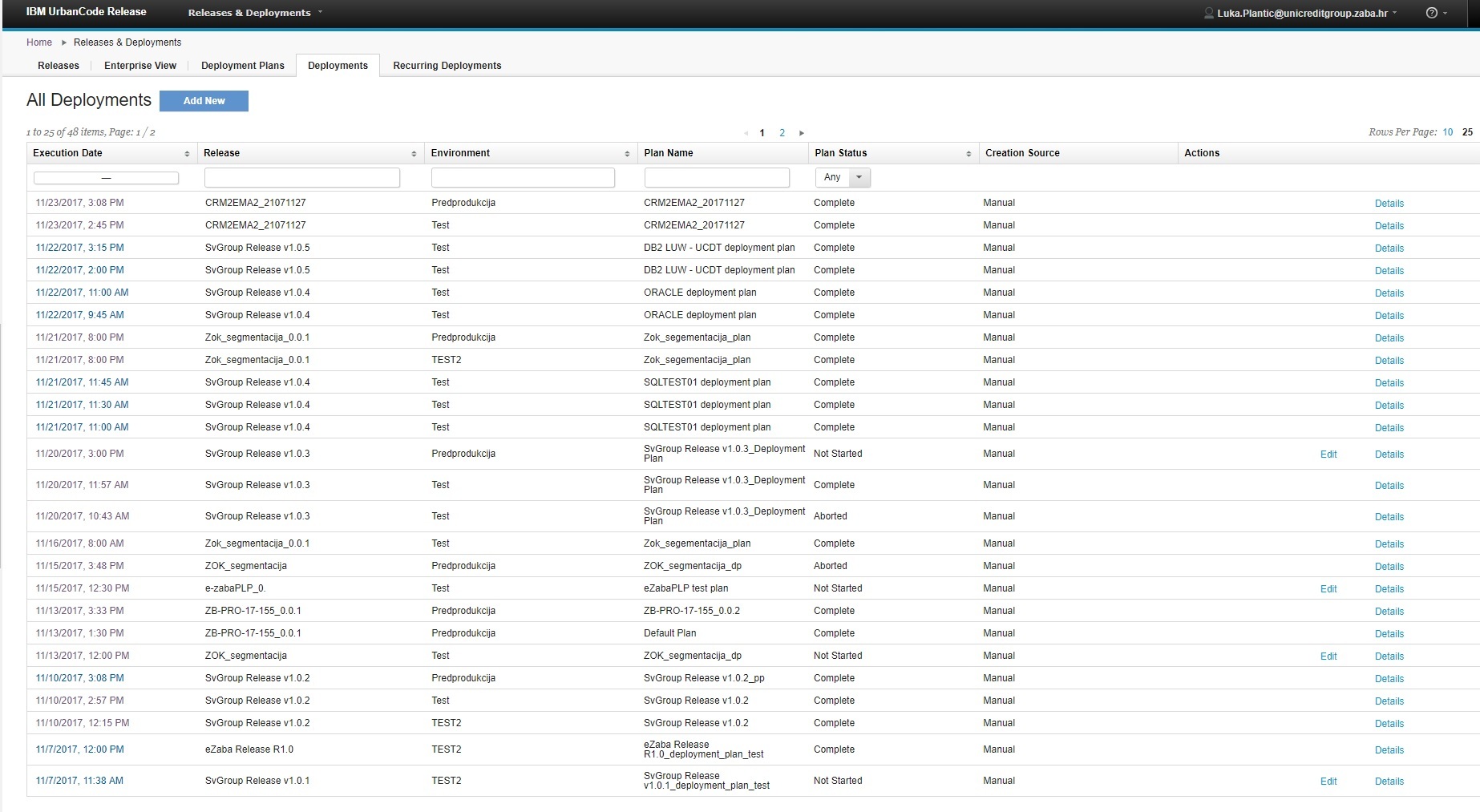

We have implemented and started using UrbanCode Release version 6.2.1.3.ifix31.944722.
There isn't a possibility to delete old (completed) Deployments.
